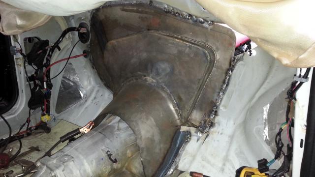

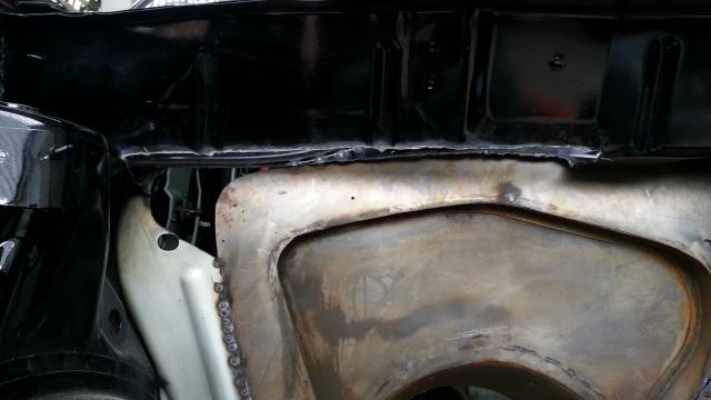

Firewall time
Spent all day today re-vamping the firewall. Since I raised the rear of the trans it no longer fit. I cut it in half and welded it into the car. Tomorrow I'll mock up the rear half with cardboard and begin on that. The weird thing at the top of this picture is a fiberglass welding blanket to protect the windshield from splatter

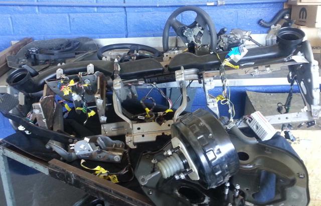

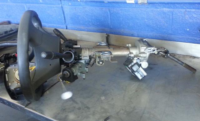

Yikes! I'm supposed to put this back together?
Ok, now I'm into some messy stuff. I took the heater/AC/blower motor out of the dash area to fit into the car to make sure it doesn't interfere with the new firewall. I won't know this till this weekend when it is test-fit. What remains here in this picture is the bare bones dash superstructure. There is also a picture of the steering assembly. I have to take it apart and delete the electric motor portion. I hope this isn't a huge deal.....I guess I'll find out.

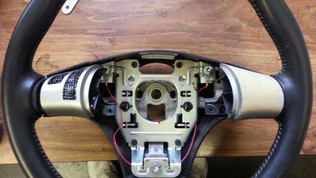

Steering Wheel Mod
Since the V8 build will have the wiring and computers out of the Camaro, and it will be basically a Camaro at least electrically, I'm going to do away with a few things. There is no way the steering wheel controls for input to the DIC or the radio or cruise control will work...mainly since I won't have any of those, I'm removing the buttons and filling the holes prior to paint. One side is ready for final sanding and the other side is just about ready for bondo. I'm trying to simplify the car, especially of things know I won't be able to have. I'm not sure the instrument cluster will work at all but if it won't, I'll remove the stock guages and replace them with AutoMeter units in a new housing that fits the stock hole.

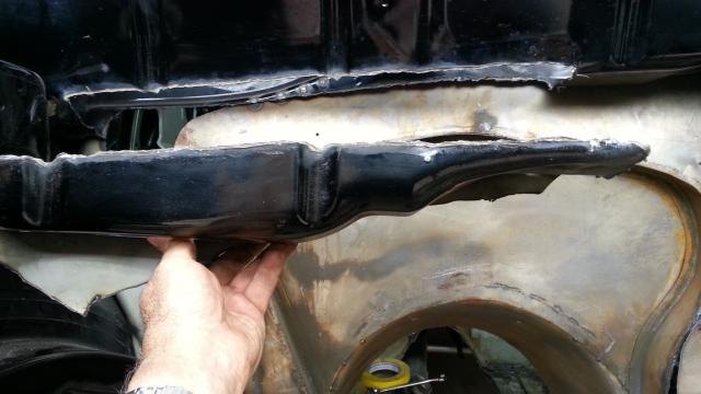

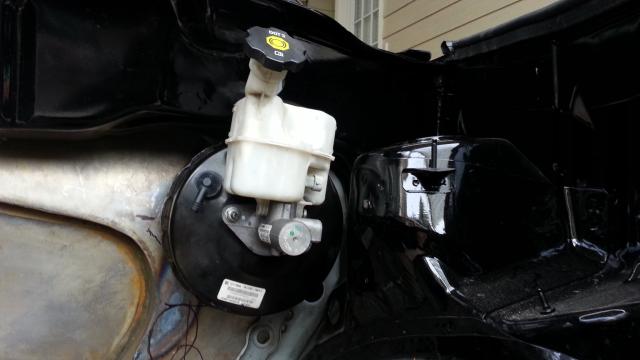

Engine Compartment Details
The engine/trans have been in and out several times. I'm going back to pick up some of the items I didn't get on the initial engine install. The master cylinder has to be moved way over away from the cylinder head. It's as tight as I can get it to the strut tower. On the other side (right bank) of the engine the bottom part of the rain sump below the cowl just below the passenger windshield wiper had to be cut off with the plasma cutter to fit the engine in. I'm now going back to fab up a piece of 19 ga. sheet metal to weld it in place. Another thing I hope to get done while I have the cutter out is to remove the upper portion of the drive shaft (exhaust pipe) hump so I can get enough clearance.

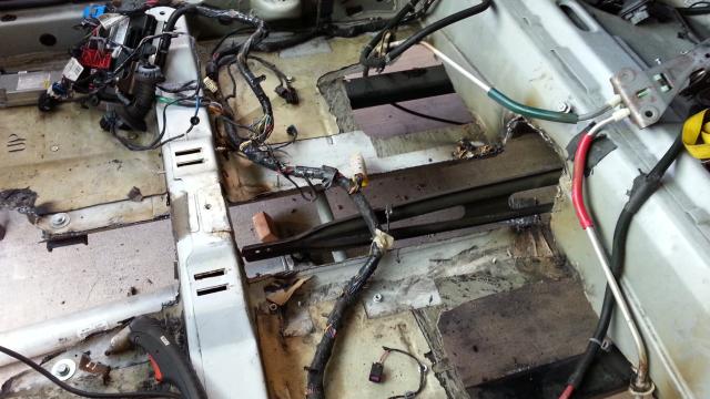

Cutting out hump
Cut the driveshaft hump out today. It's a real mess now. I hate it when everything is messy and you can't seem to get it organized. I will be fabing a new higher hump with the same bolt pattern so the e brake handle will go back in the same spot. Engine cradle goes to powder coat on Monday.
