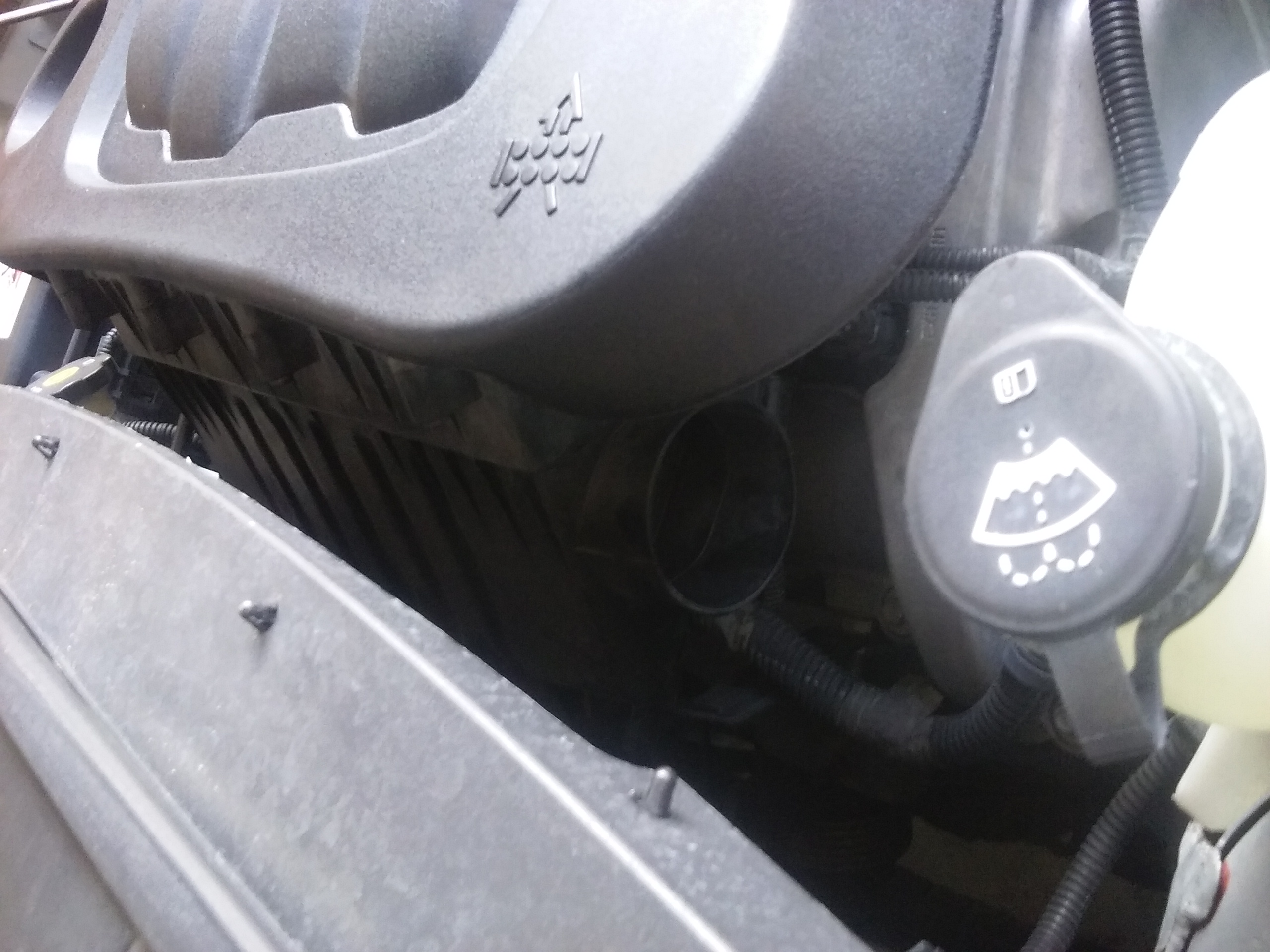

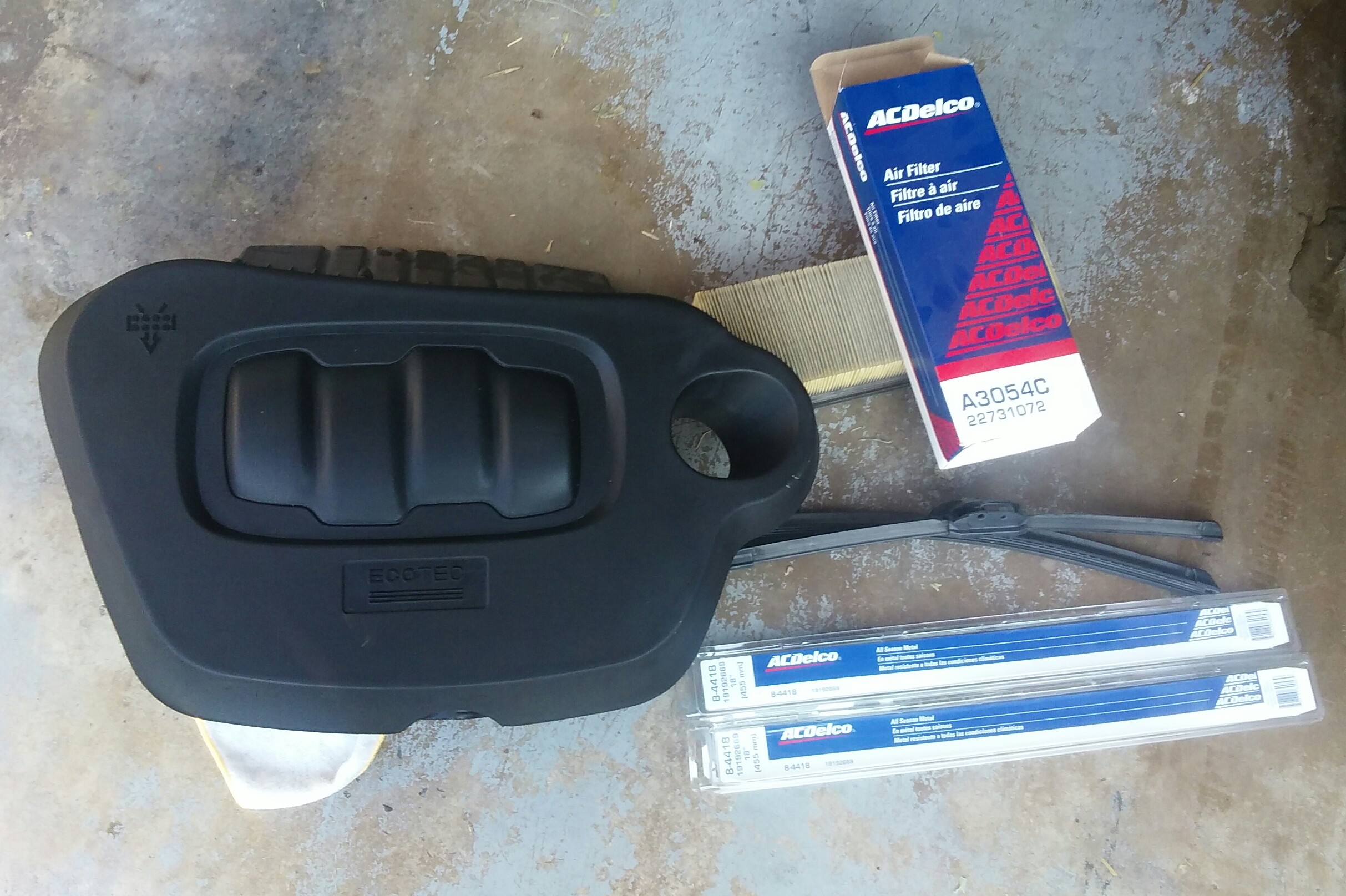

Replaced wiper blades & air filter. Air filter was too easy - almost like something was missing.

Air intake tube is missing...
Ah, the wooly worm! Good eye GB!

Only owned this HHR for 2 months.
Dang, now what? LOL

You need GM part # 15865168 DUCT. Air Cleaner Intake (it's #7 in this diagram) you can google the part number to find the best deal for you.
Alternately you may be able to fashion your own, as discussed here
https://www.chevyhhr.net/forums/how-...se-good-56573/

Is there any harm in not having one? Definitely plan on getting one soon & I was just at the A/C Delco parts house today. Grrr! LOL

You'll benefit from drawing cool, dense air from behind the headlight. Probably not a rush job, though. If I'm wrong, someone will say so.

It's not going to "hurt" anything, but the engine is breathing hot air... Get one as soon as you can.
