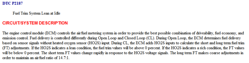

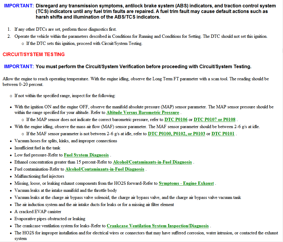

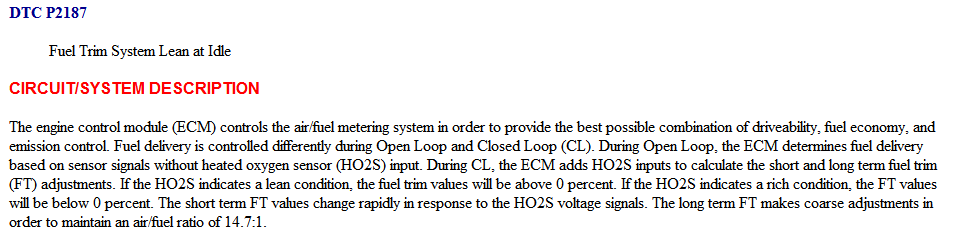

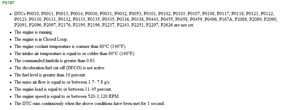

I don't know why it would have anything to do with RVS. The condition must exist TWICE in a row to set the code.
The test runs 3 seconds after the system goes closed loop, (O2 sensors warm up)
