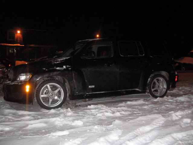

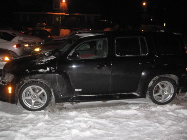

$300!!!!
not bad. kumho winters are about 80% one the front and about 35% out back. they'll last the winter.
the rims look great a little paint flaking but who cares.
thanks for all the help.
