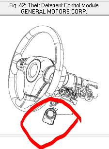

I have the original SS engine harness together with the BCM and transmission control module(same car). The ECM I bought from USA (used) but also the 2008 SS automatic transmission. The key how ever is from my old 2.4 HHR. So I think that I have to dissable my original immobilaiser system
Can it be delete?

The key talks to the BCM then the BCM send a go/no go message to the ECM. I think that as long as the key sensor and the BCM are friends it should work. If you replace the BCM get the key from that car and do a key learn.
Up to 2009 the LS/LT window controls were on the console (2009 on doors), the 2008 SS had them on the doors. I am guessing that any difference in the doors is for that reason. Looks to me like you are trying to fit the door rubber into the body hole. Should be the body connector goes into the body hole then the rubber wraps it. None of the rubber conduit fits into the holes.

I do not have the key from the other car. So I have to figured out how to eliminate the immobilaiser system. I have my original BCM,but I think it will not work with the 2008 SS wiring and needs. The door connectors(body side) lock himself to this square hole in the body. And the rubber cover goes ower the square connector. The door side is same as all others.
