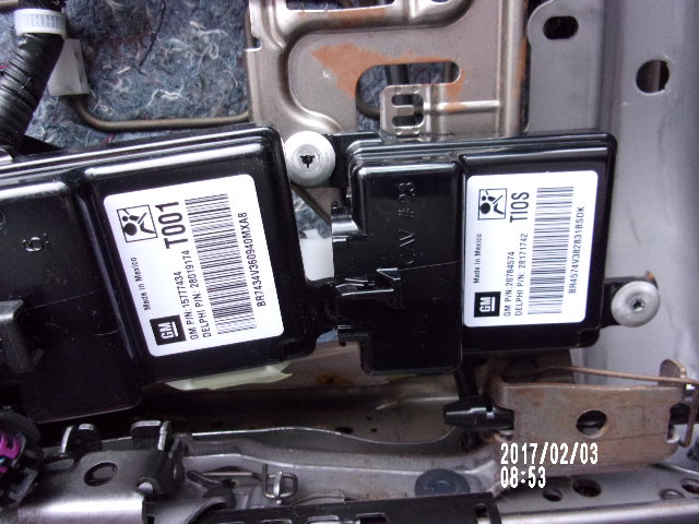

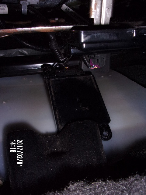

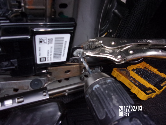

I have no idea what that module is called located under the seat, but swapping my existing 2006 sensor into the 2009 seats made everything work perfectly.
I didn't even have to remove the seat to try it. I was able to reach in from the front, unplug the 2009 module, plug in the 2006 module and fired it up. I hope to be able to pull the seat this weekend, remove the 2009 from the bracket and mount the 2006 permanently. They are sort of riveted on, so I had to drill these out on the 2006 seat, and will use screws to remount. Not the greatest pic, but you can see the 2006 module dangling and the 2009 module mounted to the bottom of the seat.

I think that you can get it done. You still have your original seat and if switching only the module did not work I was prepared to remove everything from my original 2006 seat and install it all into the 2009.
Swapping only the module has been a total success for me. The only issue is that the seat belt light does not come on if someone is sitting in the passenger seat. We always use seat belts, so we really don't need the reminder.
This did have me nervous at first, because I thought that it might affect the passenger airbag. Years ago, I covered over the passenger air bag lights with some velcro so that I could hang my Ipod. So I didn't even remember it existed until I pulled out the owners manual. I pried off the velcro and confirmed that the off light is on when no one is in the seat, and it switches to airbag on when someone sits down. The airbag light in the DIC, also flashes a couple times when the key is first switched on, and the manual states that this is the expected/normal operation.

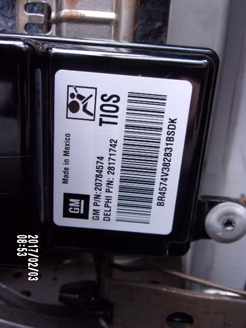

2009 Module

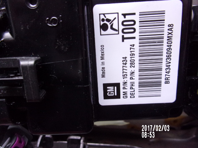

2006 module
side by side

drilling out the rivets

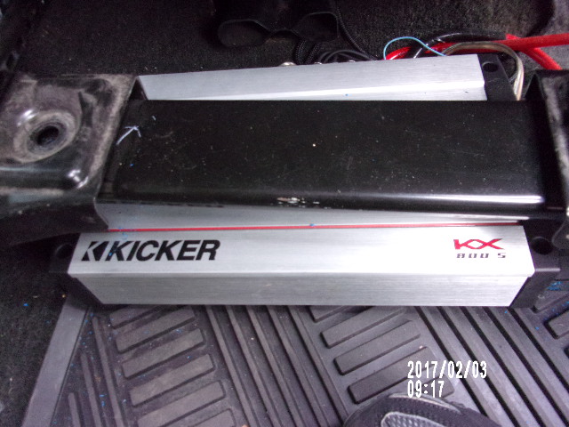

and since I had the camera handy, the kicker amp under the seat

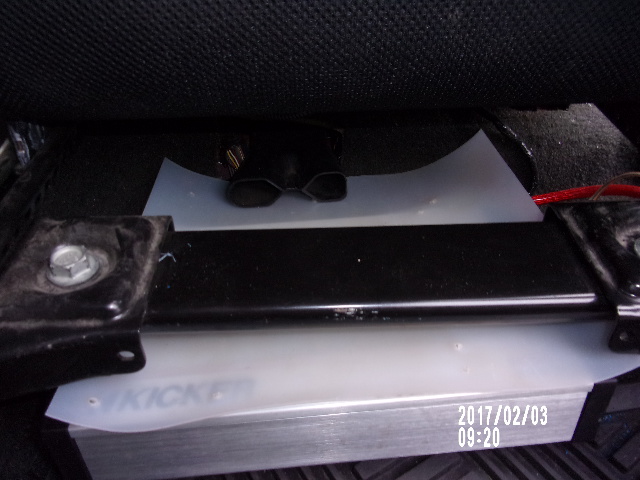

with a piece of plastic insulating it from the heater air duct.

I could be completely wrong, but I think the number under the UPC code is the number that a technician would need to give to the SDM/BCM to make the "new" module work.
