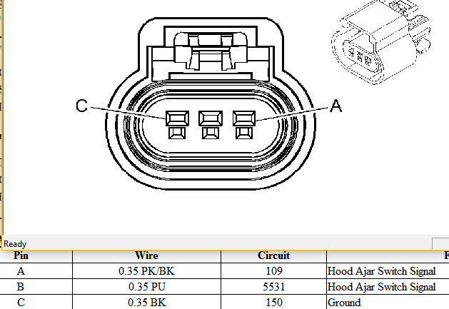

The hood ajar switch is 2 switches to ground 1 in N.O. and the other is N.C. the ground is on the driver side strut tower.
You might try the connector. Or the micro switches, You could bypass the switches if you figure out which is which. I think the PU (B) wire needs to be grounded for the RVS to work and the other open.

Ok, popped hood , RS wouldn't work, got into car , no DIC warning that the hood was ajar, I must have been thinking of the gate ajar warning.
