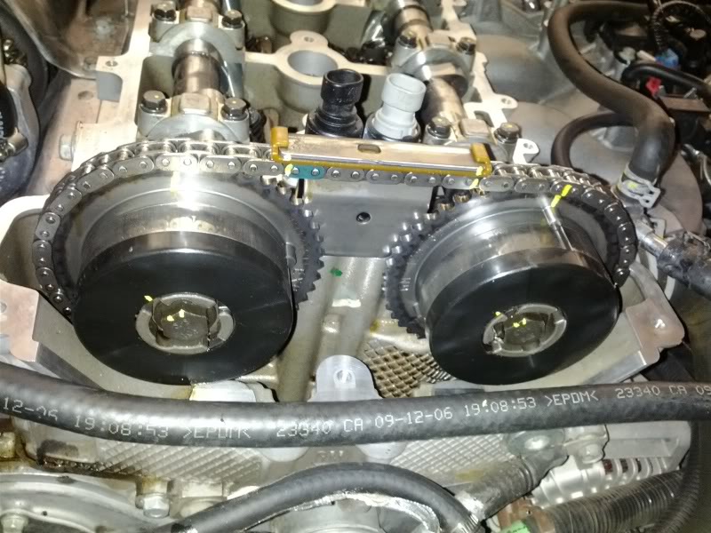

I've done some digging now these cams are the VVT set up with those big drum like pieces on the end, I would think that is the VVT part controlled by the solenoids
Notice the cam doesn't have any extra equipment on them

Now these are the lowly non VVT camshafts setup no VVT pieces bolted to the end of the cam, so the sprockets must be alittle different but I figured I would post these and Dan can chime in unless his sunburst orange HHR doesn't have VVT or does , Dan which did it have.
Old Apr 5, 2016 | 03:14 PM
  #77
Posts: 40,083
My theory is if the cam sprockets look like the second picture in Irishkiley's engine then you should be able to just better plug the VVT solenoid holes. Make sure the wiring harness is corrected and the engine has the proper ground wires, ECM and all should be fine
If the ECM is looking for cam position solenoids and the aren't there, then the code would show.
Just a theory but I think a plausible one!
