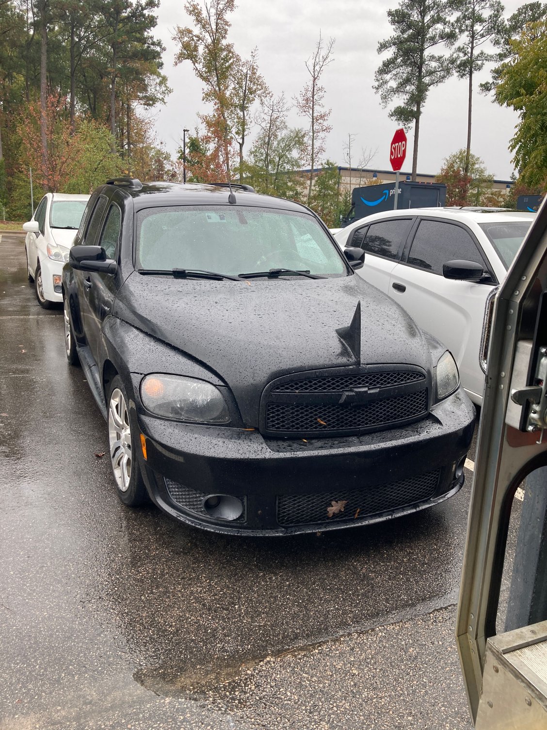

Here’s a picture of my little fella finally getting a bath from mother nature after being stowed away for over a month.
