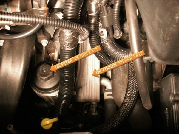

A photo of oil cooler or heat exchanger, coolant runs through it and there is a possibility the tubes have corrosion and pin holes, allowing coolant into the oil or oil into your cooling system. Coolant in the oil would thin out the oil

Wouldn't the coolant "coagulate" when mixed with the oil, causing a thickening?
Old Mar 6, 2024 | 02:18 PM
Posts: 40,083
Not in my experience. It’s milky and thin

The coolant in the engine oil has a cloudy white appearance + white foam sometimes...
just a thought: can automatic transmission hydraulic fluid get into the engine oil? if possible, this could explain the red color.
Well, the term is emulsify, but yeah. That mess looks like a emulsion. The color is determined by the ingredients. Like creamy salad dressing, lol.
