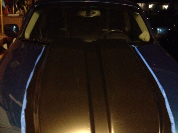

Nah, I will cut it open and seal it to the hole in the hood, when it's done.
