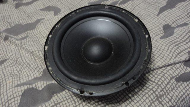

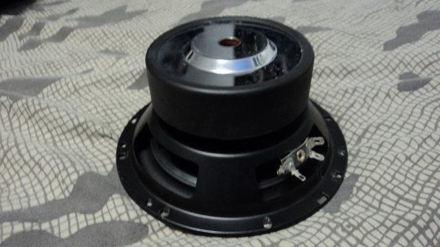

Right now I have the stock mids on an amp and they sound good.
I put these digital design 6.5"s in the door on the same power and they are no where near as loud.
Do I need to completely seal the open area that is left when you remove the stock door speakers? Do I need to completely seal the entire door?
I have the gain all the way down on the amps and always have. Maybe they need a bit more juice? I've never been a fan of turning the gain on mids/highs amps up. Always had the impression that would take away efficiency or quality.
As you can see, they are pretty beefy compared to stock mids...

If you had the factory pioneer system with sub and amp in the cargo area then the doors are 2 ohm, so you get less output with the same power, but now you can probably set mid gain on the aftermarket amp.
Did you use adapters to fit round speakers to the teardrop shaped holes?
Can't really seal the doors completely, but automotive speakers are designed for open air anyways. However, using sound dampener material on inner and outer door surfaces helps quite a bit. Keeps the speakers moving air instead of metal.

You should probably use adapters, the stock speakers are also sealed with foam to the interior panel. Without adapters there is a big gap between the speaker and interior panel that will lose sound. And you will need to crank up the amp to get more output.
