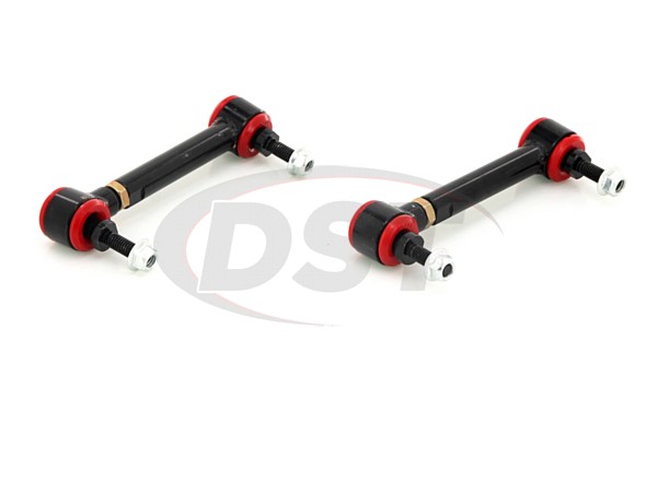

I just wanted to confirm they are in a package of two
Like this
Old Jun 27, 2017 | 11:59 AM
m_ridzon's Avatar
Joined: 01-16-2017
Posts: 384
Like this
Spot-On! You're exactly right. Pack of 2.
The shafts of them are threaded with 7/16-20 thread. Buy a piece of threaded rod as well as some coupling nuts and some jam nuts to lengthen them. Then you'll be up and running!
