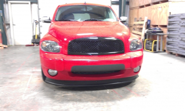

2008 lt panel big weekend projects
Greetings from the great white north (my usual winter salutation but in light of the events in Buffalo I guess I will change to) Greetings from the frozen tundra
I purchased this 2008 LT panel in late Sept and have been accumulating parts and pieces to transform it into the panel that I want to drive. This weekends projects include the usual cast of characters.

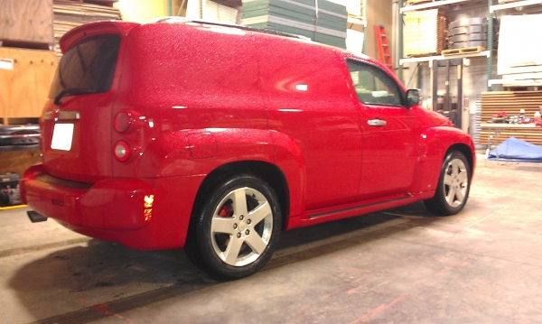

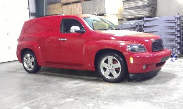

1. exterior
depos, ss rear spoiler, luggage rack cross bar delete, lawn and garden front
spoiler/air dam, and black out grille

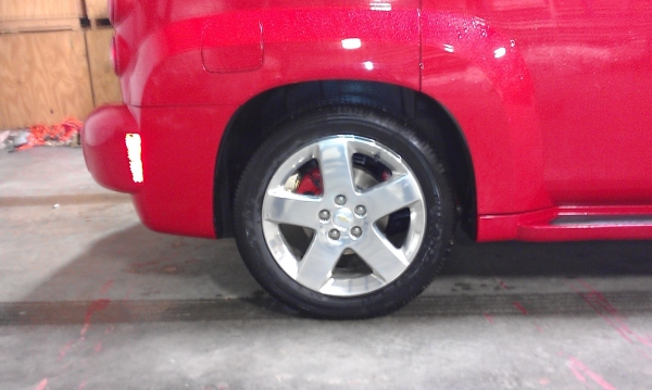

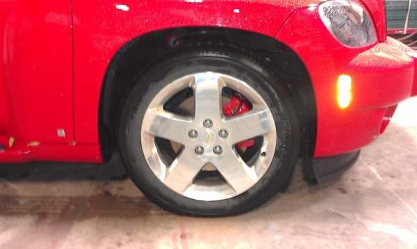

2. chassis /suspension
ss springs front and rear, kyb struts and shocks, ss brake rotor conversion
on the front with new pads, complete cobalt rear axle swap with new
calipers and rotors/pads and new sway bay links(hoping to rid the car of
"the noise").
I have a few more things to do but for now the daily driver is pretty close to where I want it. I know that all of this is irrelevant without pictures (I really thought I knew how to post them) and I will figure it out shortly

results of this weekends shop time
1st attempt at posting pictures hopefully they are the right size!!
A lot of work but it all came out great although "the noise" is still in the front a little quieter but still there when on bumpy roads

Mighty spiffy!

nice

Neat panel! For that noise up front check the sway bar bushings and the rear lower control arm bushings

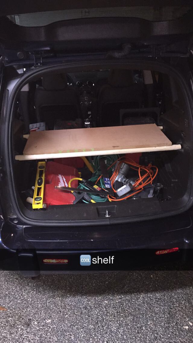

Built this shelf not quite done, but mine didn't come with the factory shelf back here Name:  lrR0pqZ.jpg
