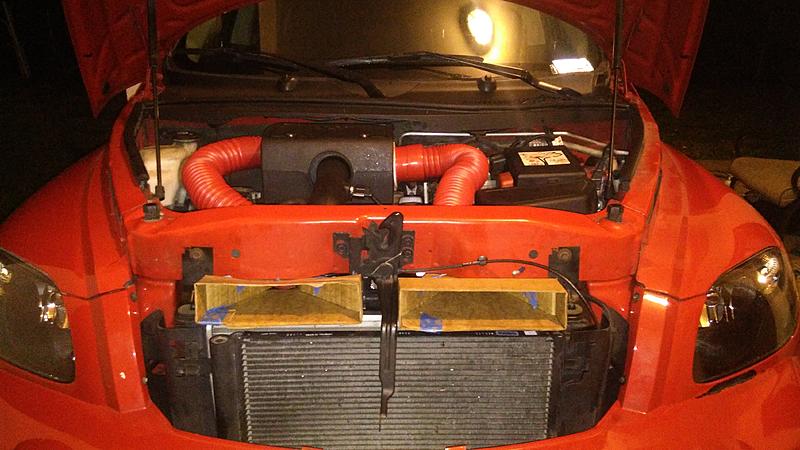

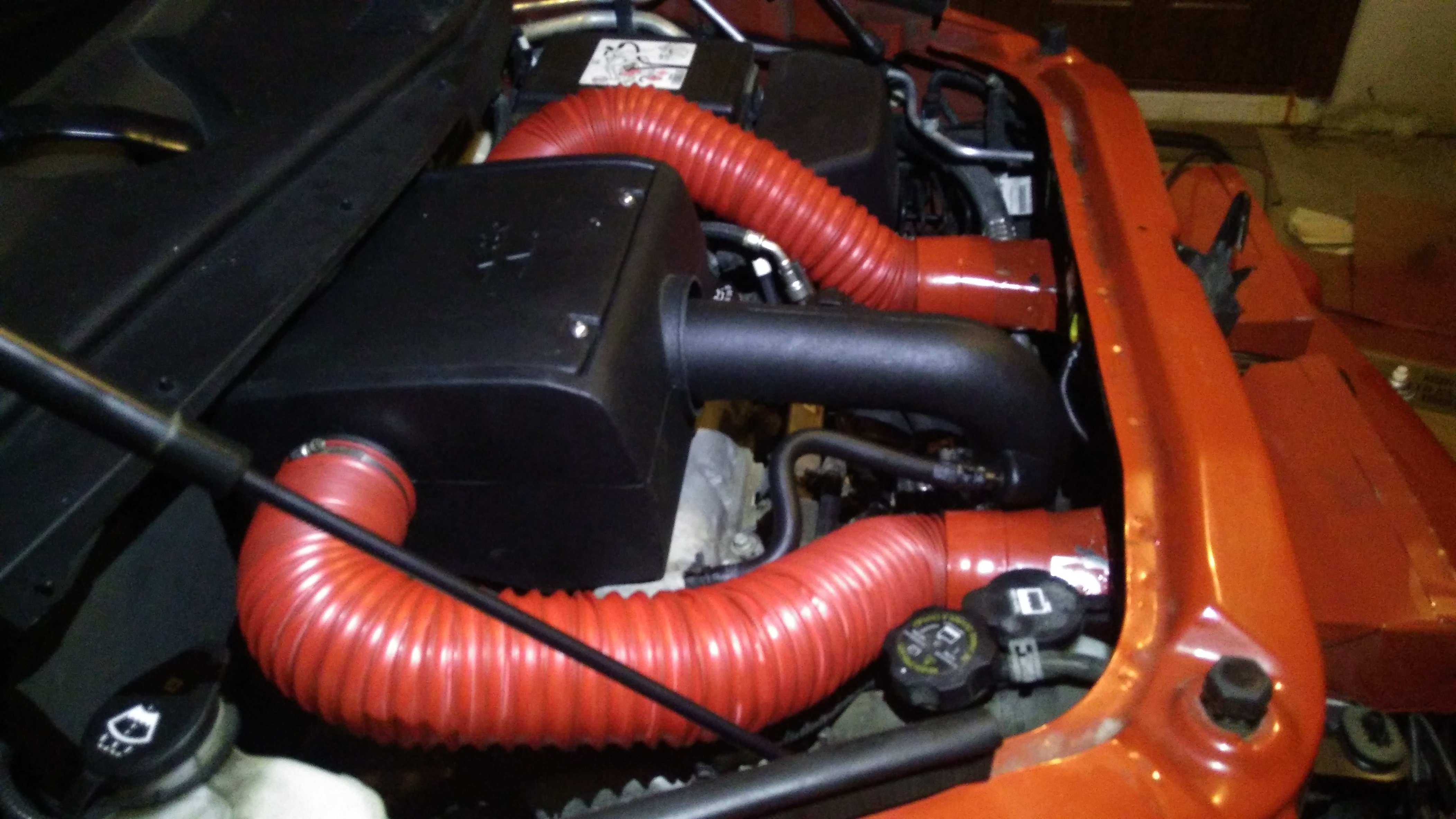

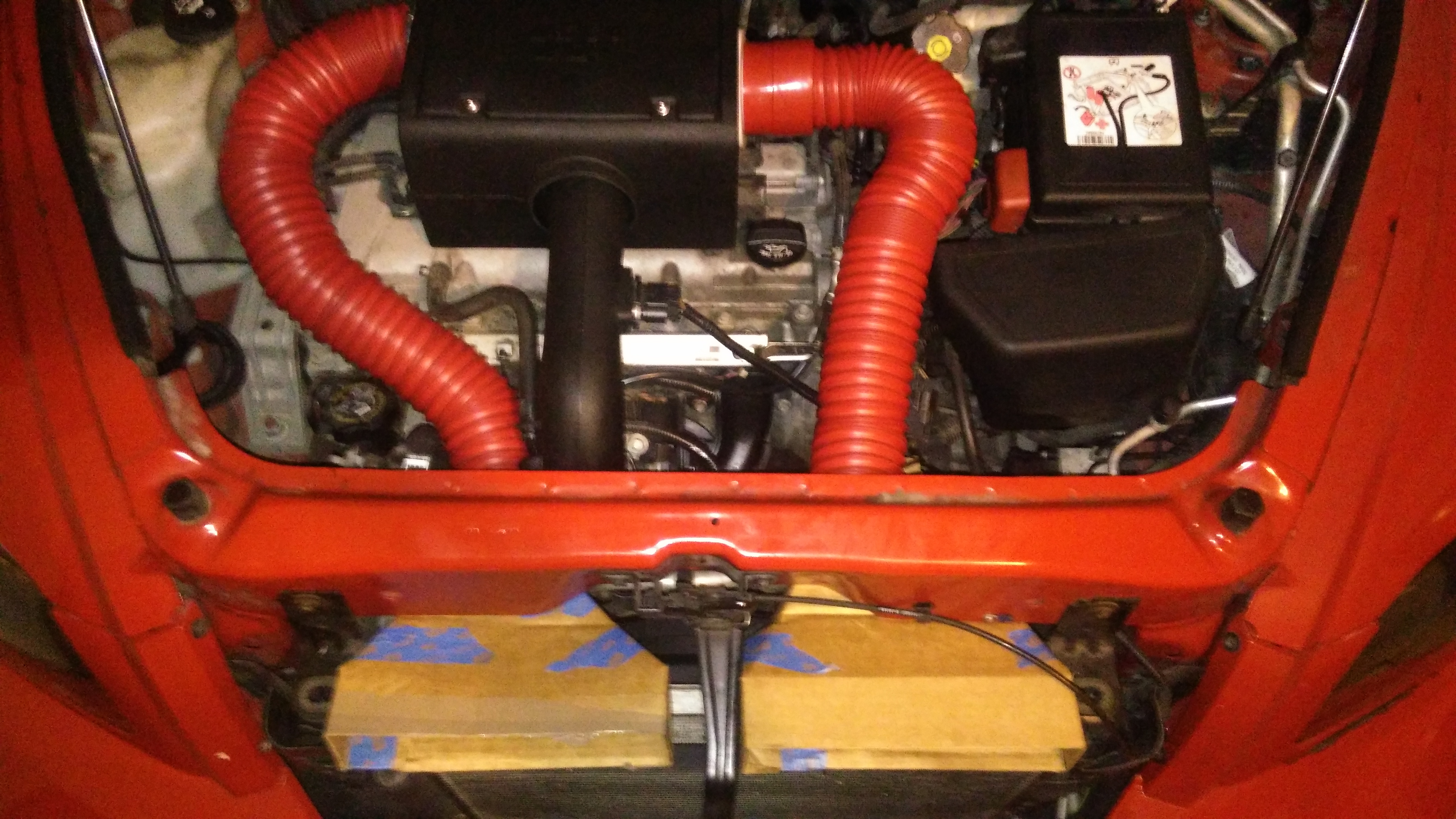

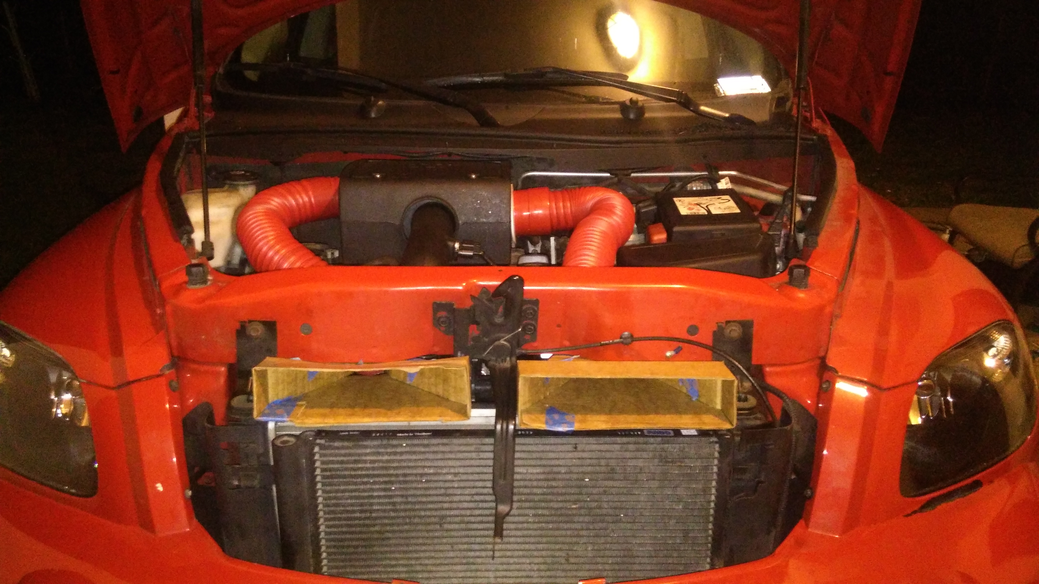

Today I ran a can of seafoam spray in preparation for plugs and an oil change tomorrow. At lunch today at work I machined a flange for my new intake house out of Teflon. I also finished my final mock up for the intake. It only took about ten trials to get fitment correct. I'm glad I had quite a bit of cardboard around that hasn't been recycled yet. Do you guys see anything wrong with this set up that might cause problems? Just looking for opinions before I spend the time to make the scoops and more importantly, cut up my new air box tomorrow. I'm planning on leaving the plastic cover on the radiator off.

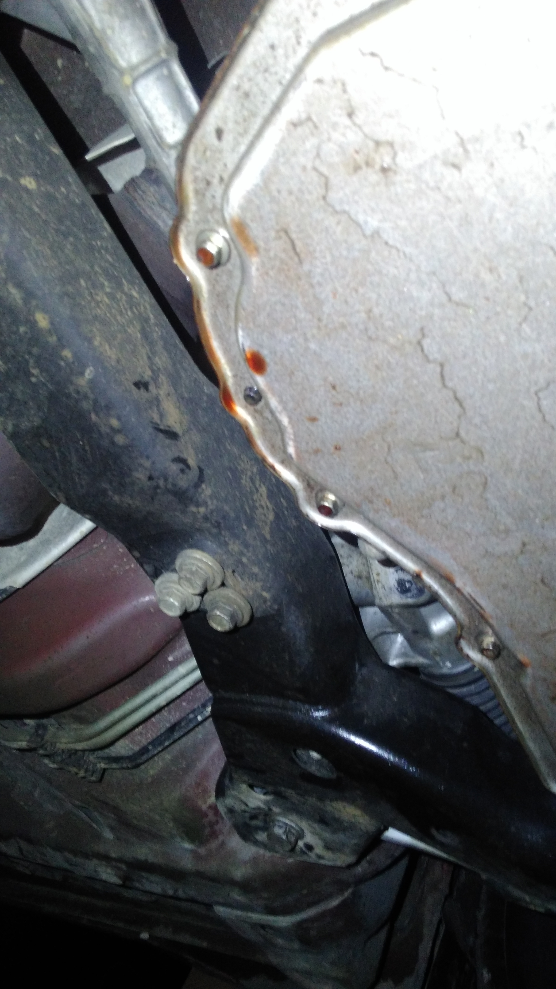

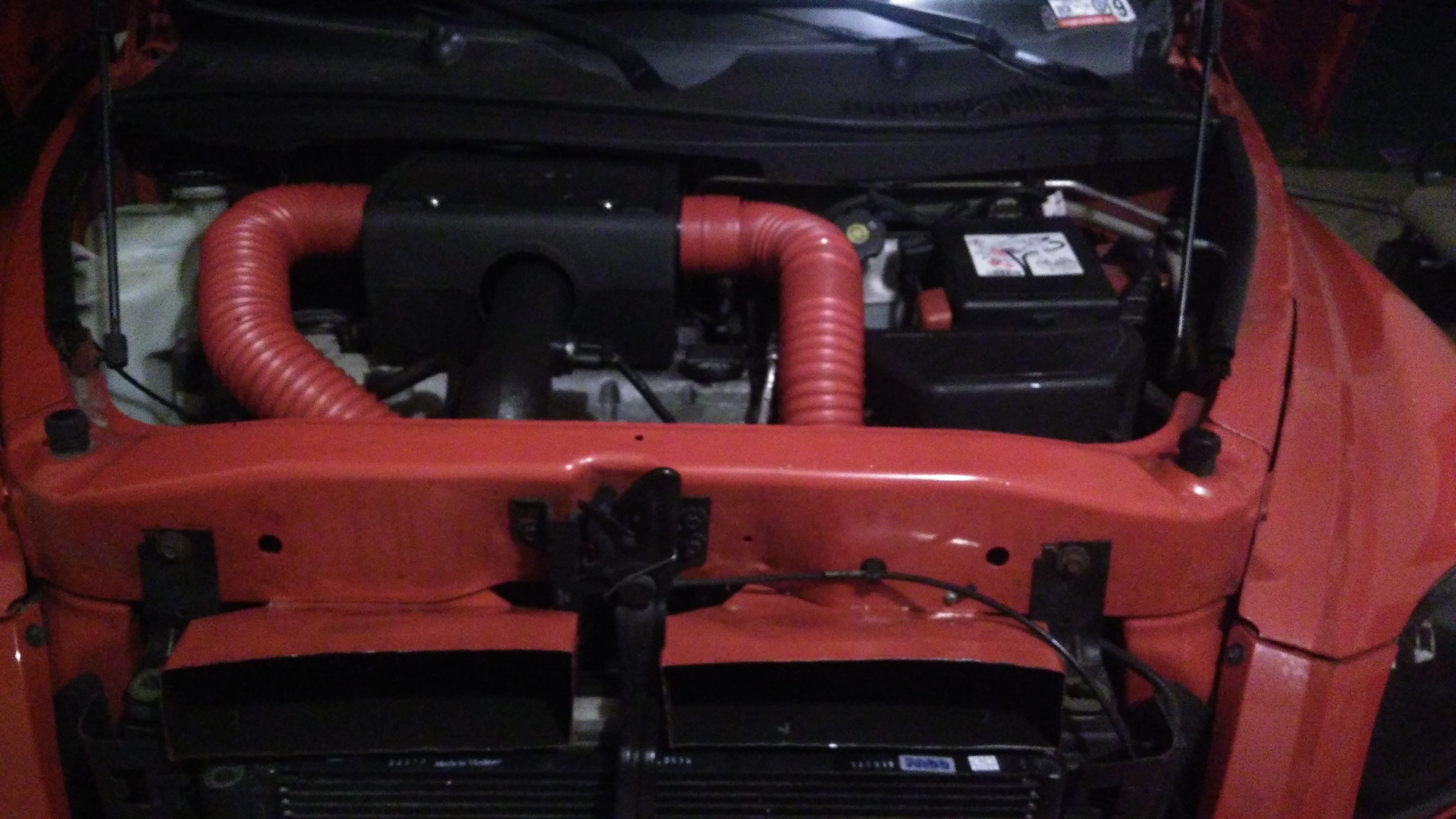

I found this seepage from the transmission pan today while doing an oil change. The gasket had been broken for some time I believe. I drained the atf and got maybe five quarts in the drain bucket. But fixed now and with the correct fluid level, new filter, and gasket. Also did plug change, cabin air filter change, and finished up the new intake hoses and scoops. I'm sure there will be changes that will need to be made, but happy with them for now. Also installed a dry filter bag on the air filter just in case any water gets up the hoses during heavy rain.
