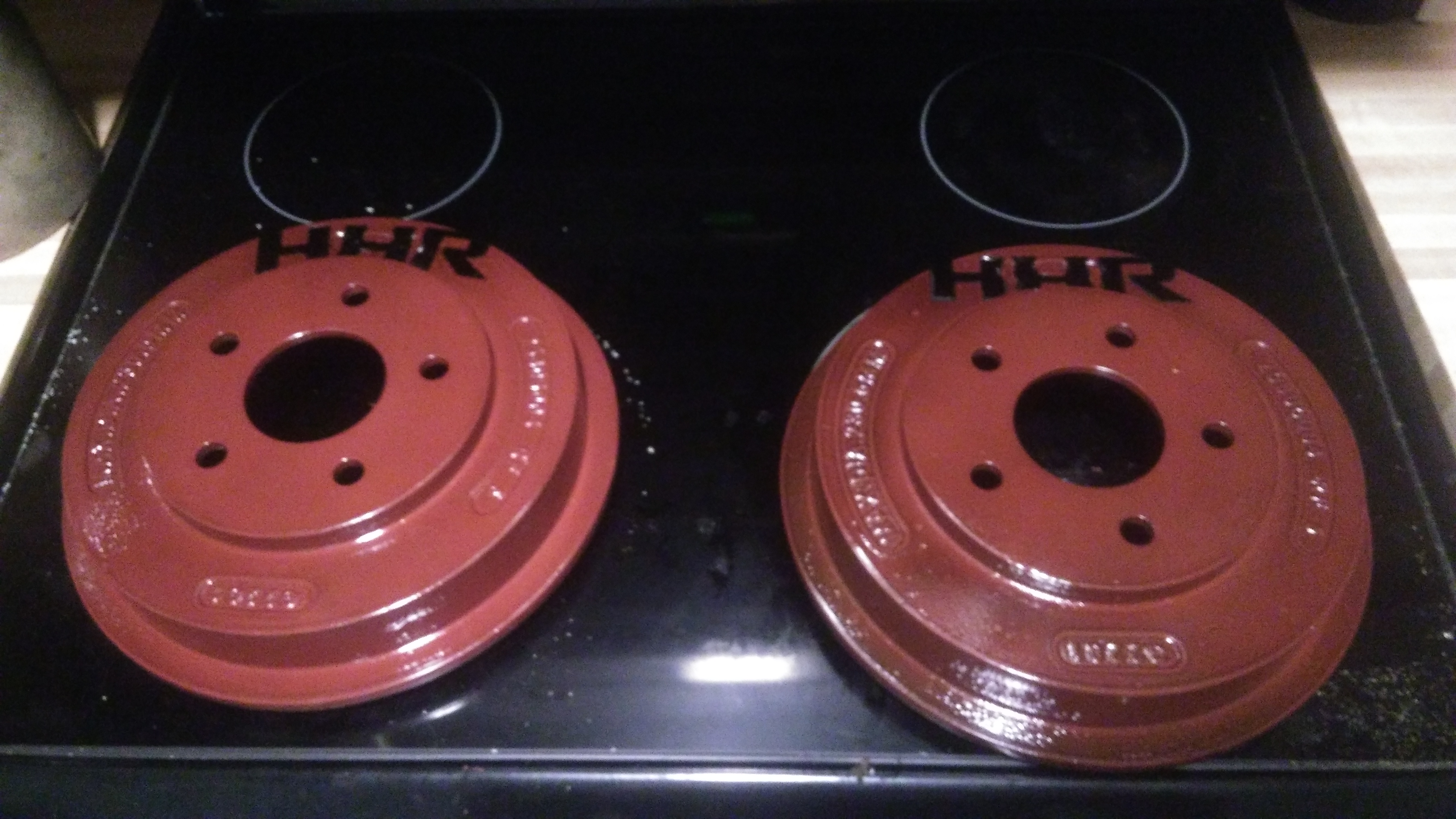

I thought I was finishing my drums today. After paint, dry, clear, and dry, I followed Rustoleums directions on the can to cure the paint, and this is what I have now. The vinyls didn't hold up to the heat and my drums are now a burnt red/brown. Oh well, more painting tomorrow, and I'll be holding off of the vinyls for the time being

Never heard of putting clear coat on painted drums.
Fwiw. I've painted drums on several vehicles before. Never used the specialized caliper type paints. Just used high quality gloss rattle can stuff.
4-5 coats on 2 drums.......or till the can is empty.

I think that little pop of color will look good on the flaps. FMG, I used the clear to protect the stickers. I'll still throw a coat of clear or two on today, but no baking to cure. The stickers were a little big anyways, so I'm not too upset about ruining then.

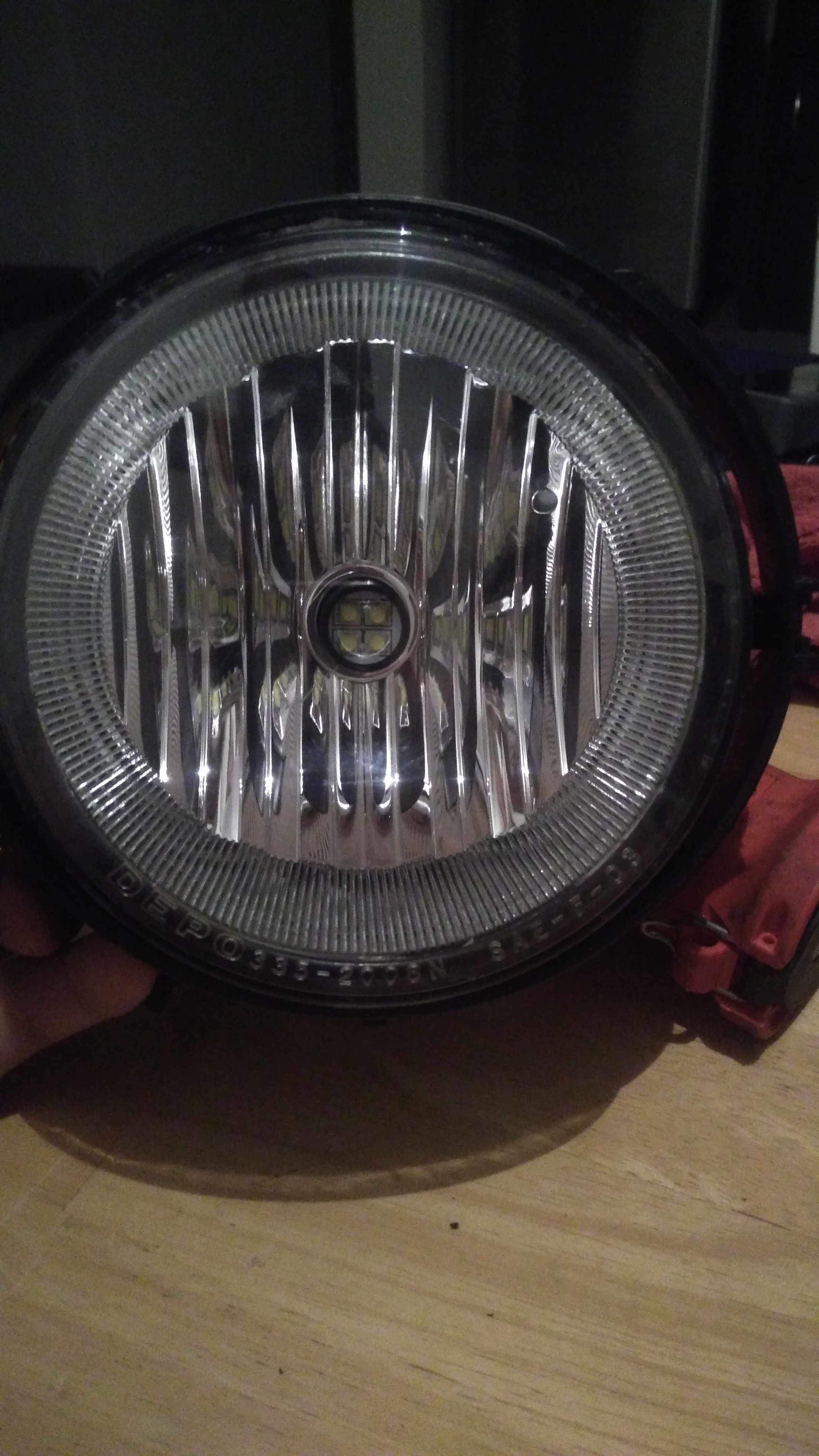

Today I finally resealed my factory style Depo fog lights. They'll have LEDs bulbs a pictured. I tinted from a spray can and inserted a 120 mm halo into the reflector. The 120 fits perfectly around and doesn't hit the lens. I tinted because I didn't want to have it be white and to try and darken the look of it to match the black Depo head lights. The120 mm refracting rings I also bought from super bright LEDs.com didn't fit behind the lens without cutting, so I just tinted the halo itself. You can see the individual LEDs, but you'll be able to in the headlights as well, so at least they'll match ugh night pics of lights. Even with the tint, they're super bright. Won't install for a few weeks though, I've got bumper work to do first.
BTW, I was kind of scared to work with the headlight sealant, but it is really super easy to do, as long as the wife doesn't mind baking car parts in the oven.

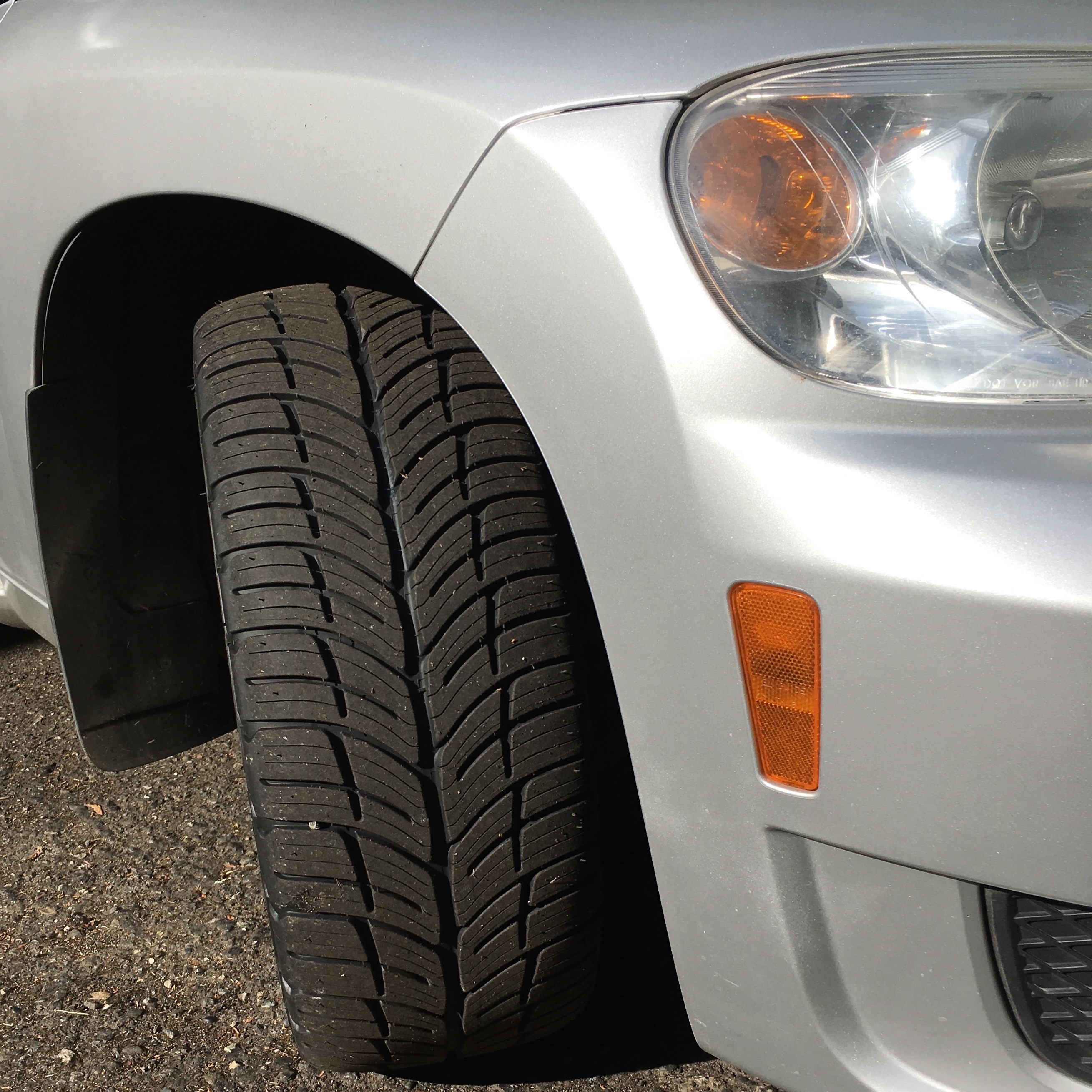

Installed a set of Goodrich G-Force comps. They handle very well in the rain. The ride is a lot quieter.
Also installed some rear cobalt SS coils.
