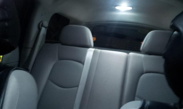

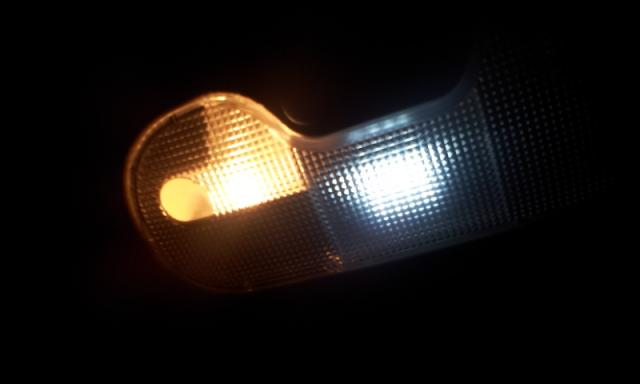

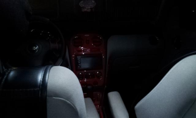

Here are some pictures of the lights. The last one is the license plate lights. They are brighter than the picture shows. The one picture shows the difference between the led's and the original bulbs.
