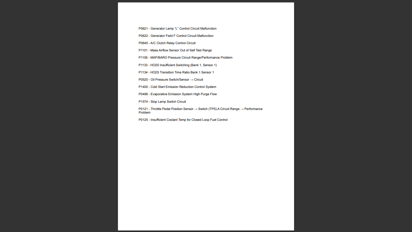

Here are updated images of the doc (because for some reason every time I try to upload it, it gives me an error)
I checked the battery, it read 12v when off, and when cranking, it read 11.2v.
As for the status of the codes, my mom's friend is bringing me is code reader (he brought it before and that's how I got all these codes). We were gonna clear them all, try to start the car again and see if any of the same ones pop up and which ones don't pop up.

DON'T clear codes!! They will clear themselves when the condition is fixed. They are not the problem, they are diagnostic information.
Anything under 12.3 volts is a dead battery.
Most of those codes could be from a low battery.
