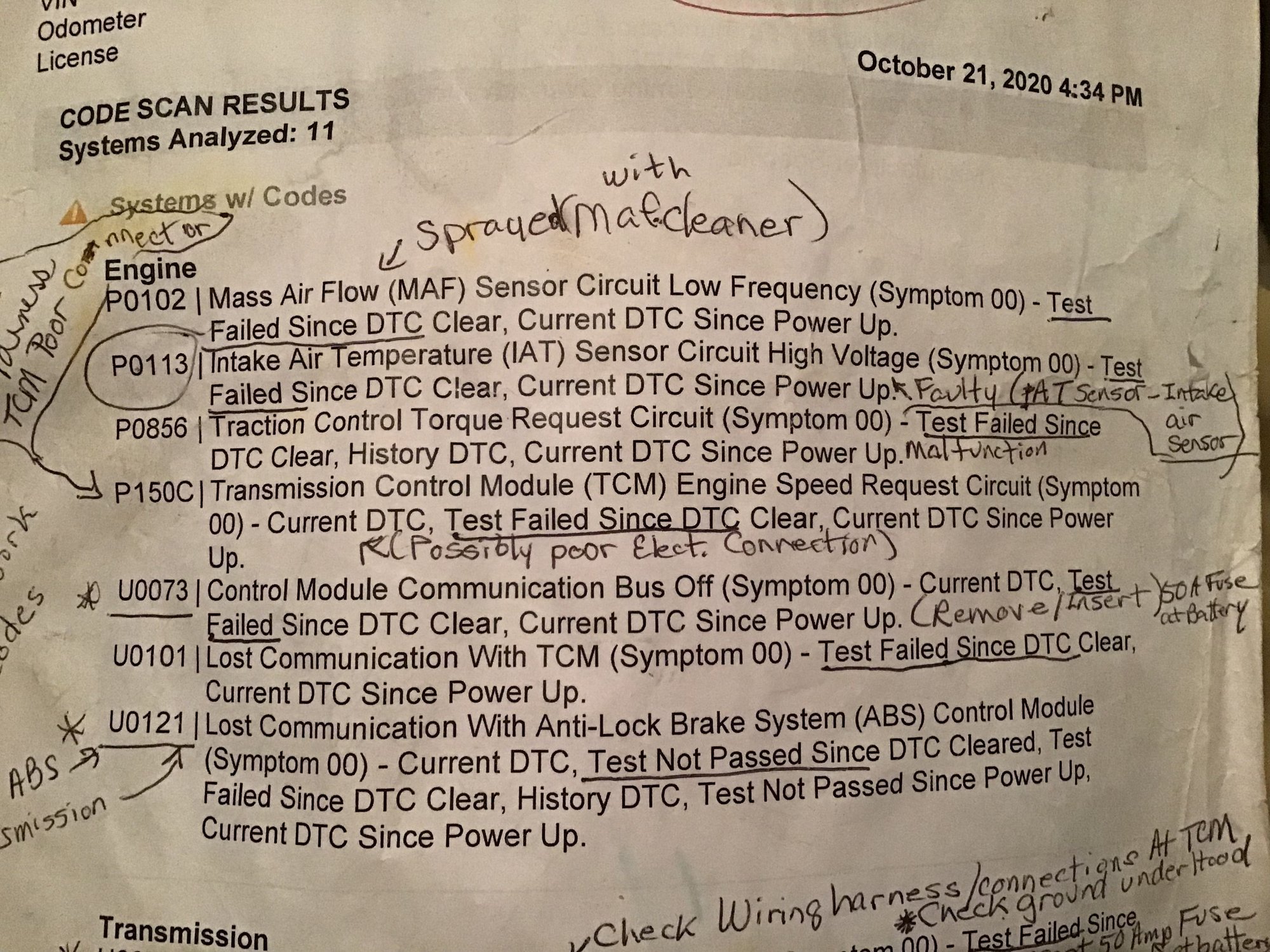

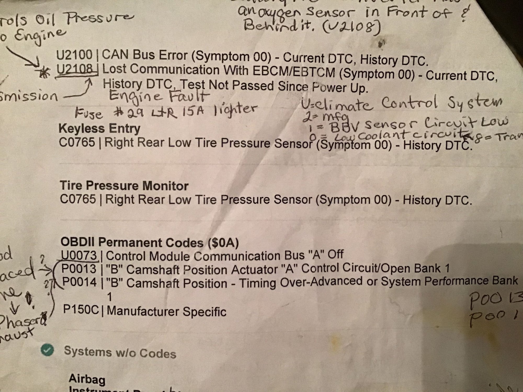

Hey all thanks so much for your time viewing this thread. I was driving my hhr into town, I stopped at a Dairy Queen and the car started to run terribly right after we left. Shifting gears became very loud and rough (automatic transmission), it had almost no power. Luckily it got me home. Then the next day I could not get it to crank for a couple days. Than it started up fine ran great for a few miles, than proceeded back to the aforementioned problems. Side notes of things I noticed the car would run great, and when it wouldn’t there was a lock icon showing up on dashboard. Have some pictures of codes it was throwing. Any leads greatly appreciated.

Would like to add I have not been able to start it for a few months now, and also it will no longer allow for scanning of codes. So these codes were from a while ago when it could be scanned
