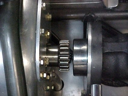

Weld the crankshafts together for a straight eight? They used to do that back in the day on dragsters.
You kinda dating yourself there GreyBeard. I saw one of these run down the strip at Houston raceway park in the early 90's. They were obsolete then, it was just for entertainment
Old Dec 28, 2018 | 09:08 AM
Posts: 40,083
The cranks aren’t welded together, but coupled together
