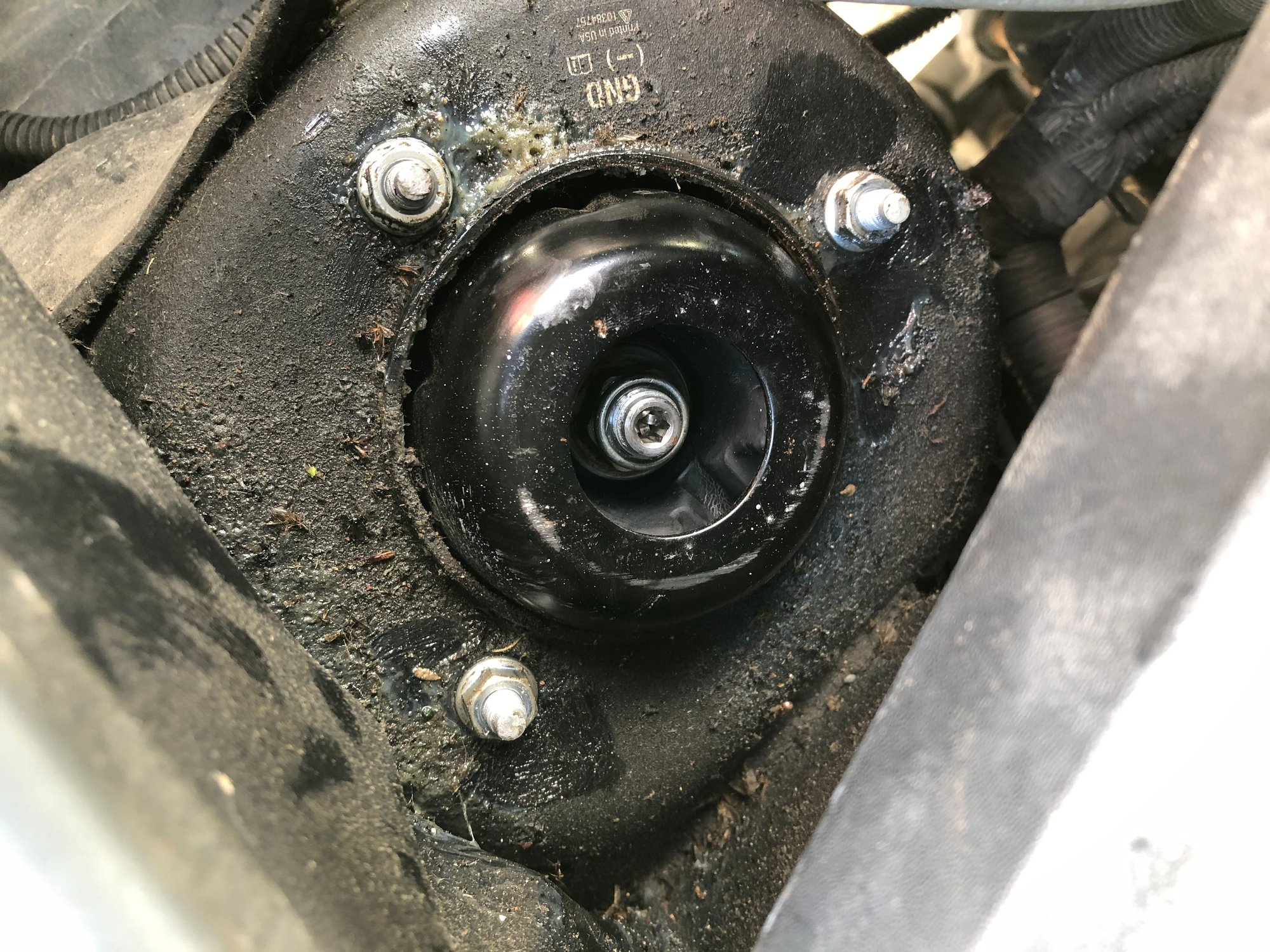

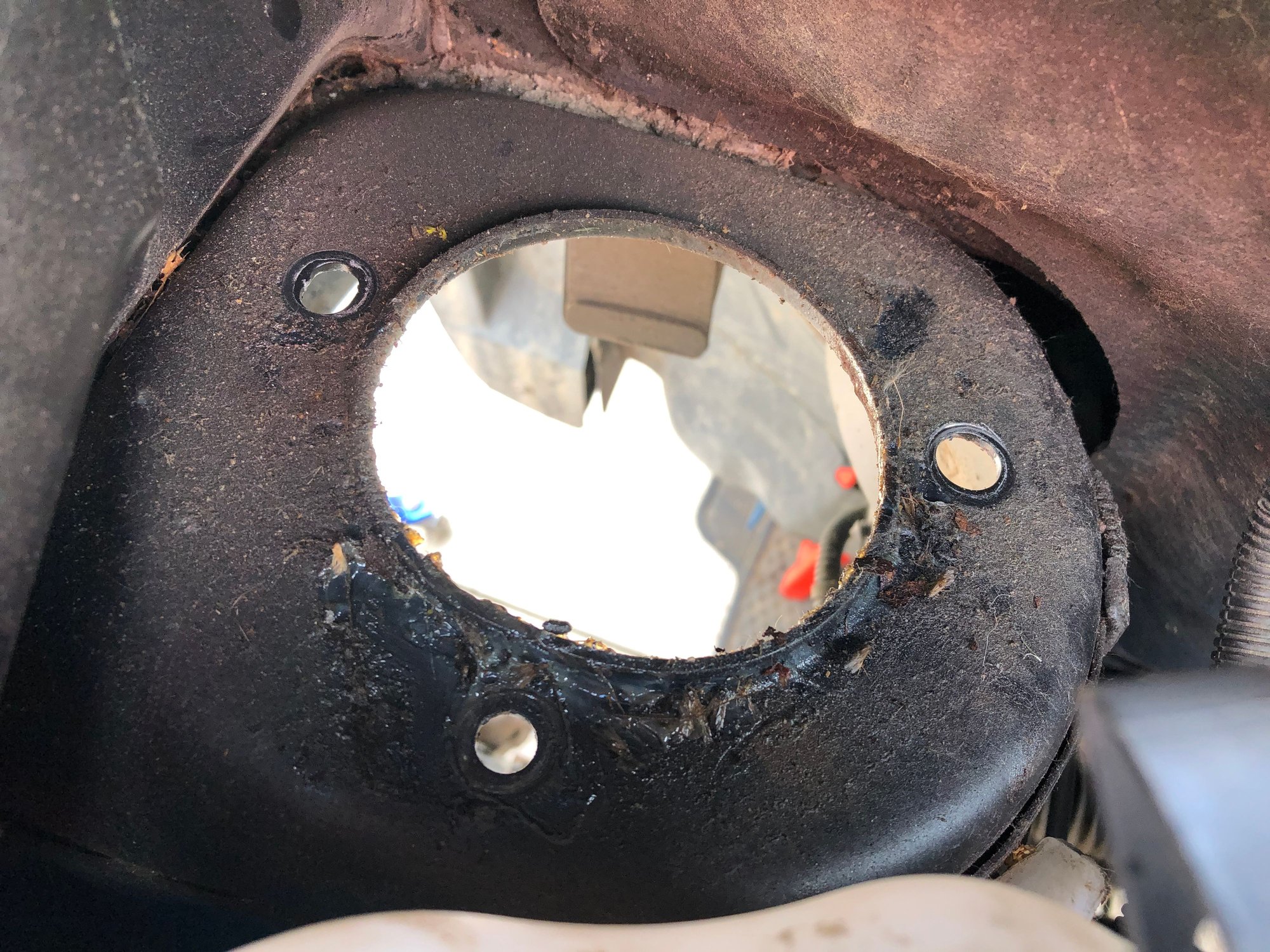

Yes, and the body, not out toward the fender. I mention the brackets as when the strut is out of the HHR they give you a point of reference!
the flat spot on the upper bearing plate’s orientation is toward the rear of the HHR, it can be rotated into position to align the 3 bolts , so for instance in the passenger side , before you lift the strut into the fender well, ensure that flat spot is pointing to your left
on the driver’s side it will be to your right, Or towards the firewall
This is my passenger side , flat spot points towards rear
Driver’s side, flat spot points right
