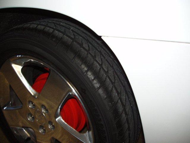

26.1" tall tires on mine
Ok update, I had my 225/50/17 tires installed...As discussed, they are 26.1" tall..
Which when compared to my oem 215/50/17 is an overall height diff of approx +.600"

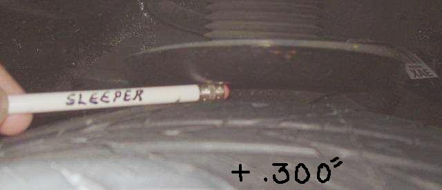

divided by 2 = .300" more sidewall... So after checking 1st front tire very carefully.
See pencil between tire & strut plate (very loosely fit).. (apologize or VERY crappy pic)..
Pencil od mics out at .301" (min)..
So, I have .300" (a bit over 1/4") clearance from tire to strut plate.. Totally pleased with ample clearance..
I promise better pics coming..
Fwiw: NOT saying any 26.1" tall tire will fit ALL, a lot depends on tire type, mfgr, rim etc.. So use caution..
But these babies fit fine & ride smooth as silk.. & each tire is 1 lb lighter that stock..

Looks like lots of room left

Mucho room..not even close to rubbing anywhere..

Maybe this pic is a little better.. (Self Portriat setting) I'm learning, thanks Sam.
